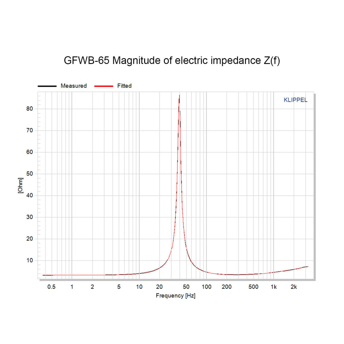

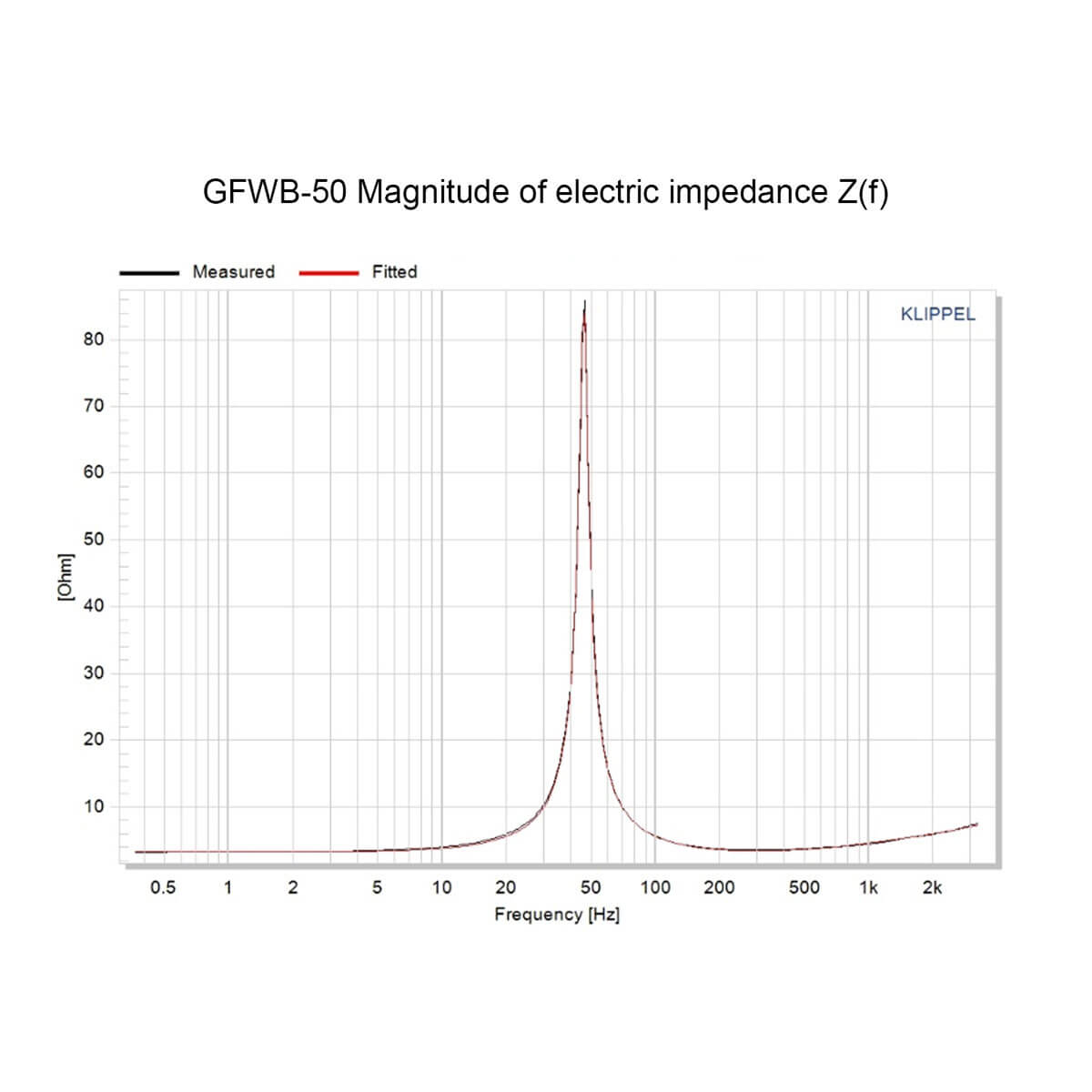

GFWB-50
GFWB-65
Glass fiber+ rubber
Glass fiber+ rubber
4.0±15% Ω
4.0±15% Ω
3.1±10% Ω
3.1±10% Ω
84.5±3 dB
85.0±3 dB
46-6K Hz
39-5K Hz
46±20% Hz
39±20% Hz
32 mm
32 mm
30 W
30 W
50 W
60 W
10.338
10.919
0.4
0.405
0.416
0.421
11.171 L
23.4071 L
66 mm
73 mm
119 mm
143 mm
Ferrite
Ferrite

Magnitude of electric impedance Z(f)

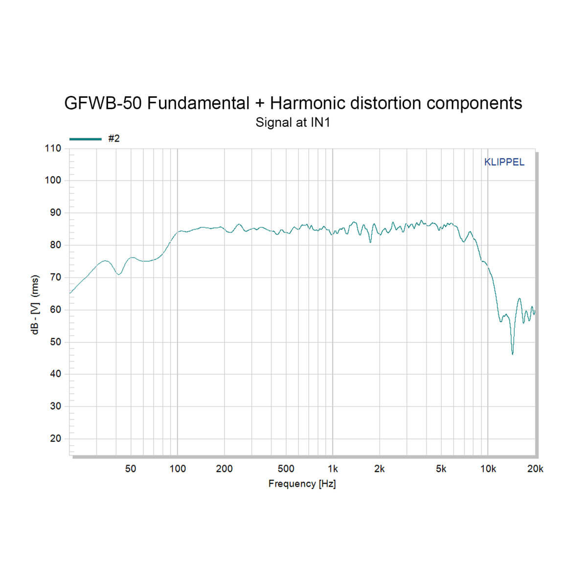

Fundamental + Harmonic distortion components
