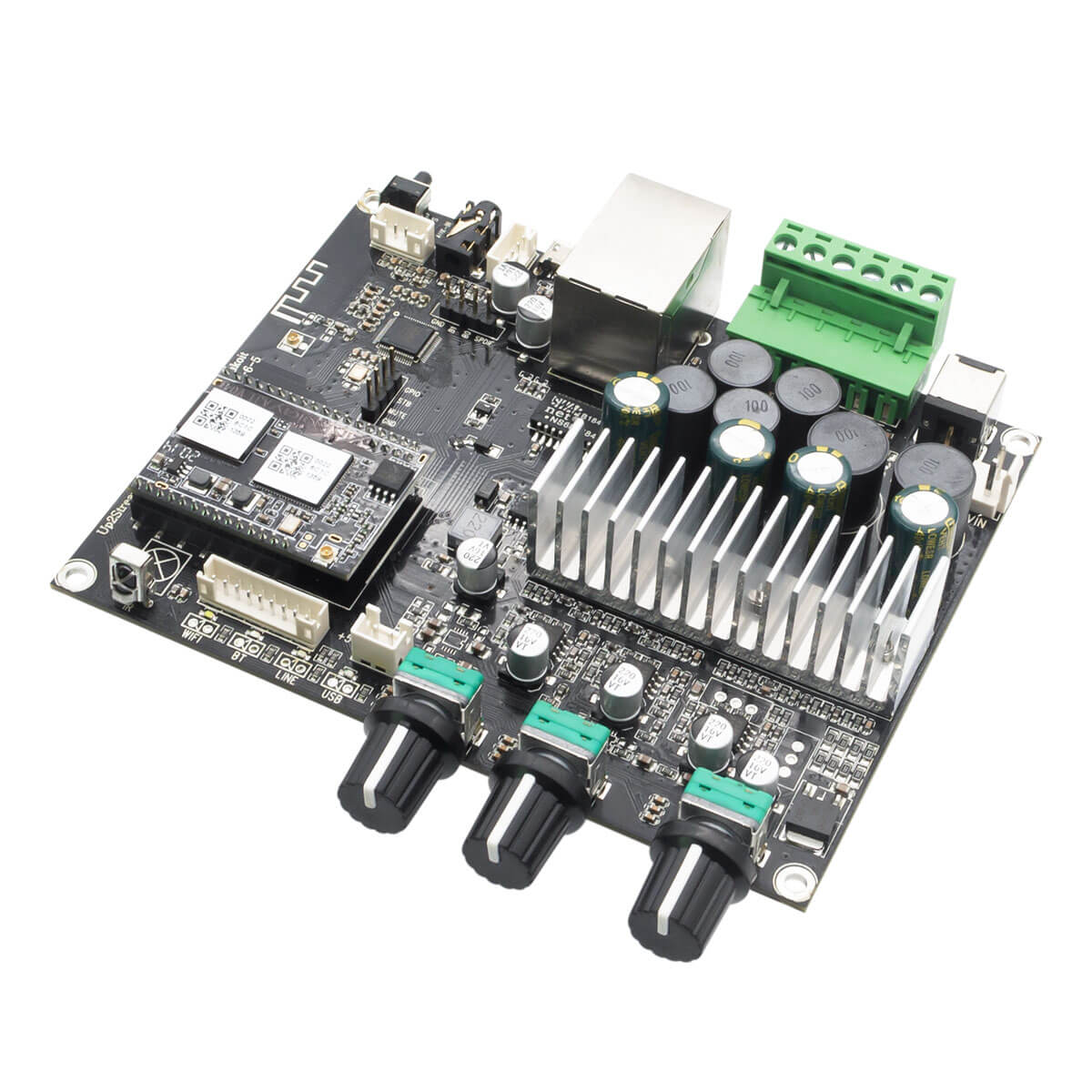

Up2stream AMP

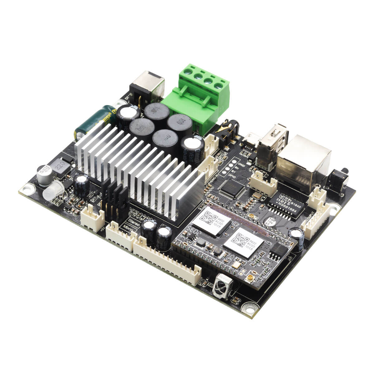

Up2Stream AMP is an amplifier board equipped with both WiFi, Airplay, Spotify Connect and Bluetooth 5.0, designed to enable your existing audio system with wireless capabilities. It offers a comprehensive solution for DIY enthusiasts who want to create a personalized wireless audio system.
The Up2Stream AMP has the ability to switch between stereo and mono mode. In stereo mode, it delivers up to 50W of power for both left and right channels, while in mono mode, it can provide a maximum of 100W for a single channel by mixing the left and right channels.

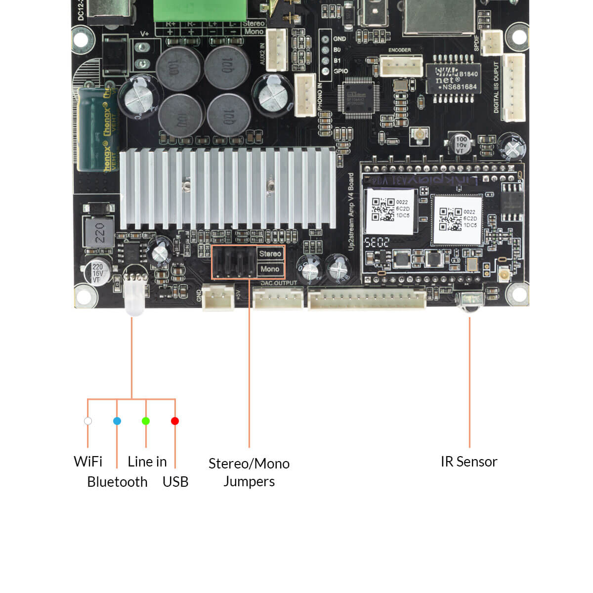

Mono/Stereo Mode

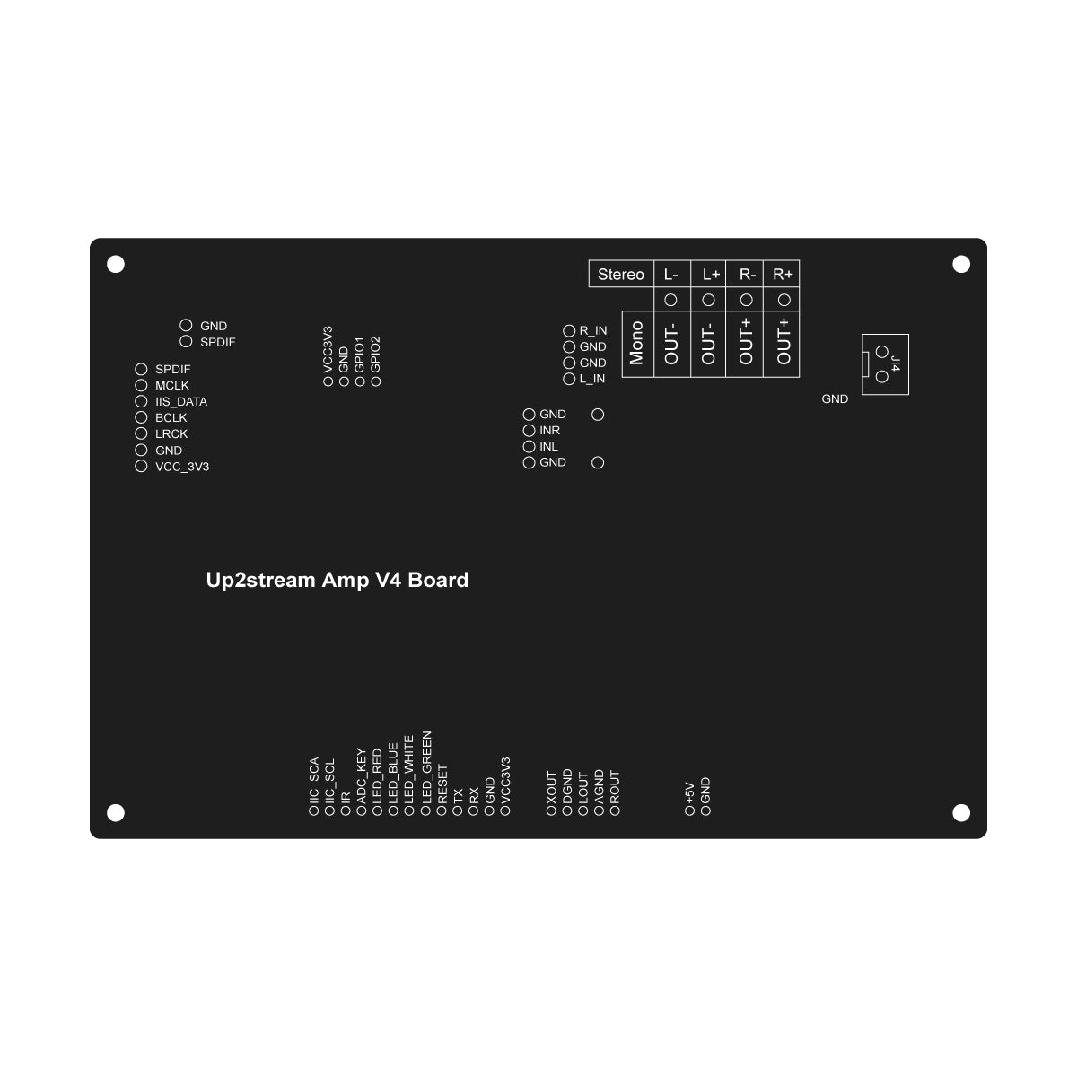

The Up2stream AMP is a versatile amplifier board that can function as both a stereo and mono amplifier. You can easily toggle between these modes using the jumper located on the board. This means you have the flexibility to use the board in either stereo or mono configurations depending on your needs.
Powerful Home Amplifier Board
Under stereo mode, the Up2stream AMP is capable of delivering a maximum power output of 50W x 2 at 4ohm and 24V. However, when switched to mono mode, it can deliver up to 100W of maximum power output at 4ohm and 24V. This means that the board can provide a higher power output when used in mono mode compared to stereo mode.

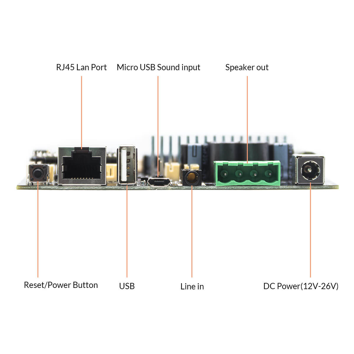

The Up2stream AMP comes with a range of ready-to-use interfaces, including a 3.5mm line in, micro USB audio input, speker output and a plug for SPDIF in, Line in, Line out,Mono out, LED indicator, IR extention, and ADC-key. Which enables you to create a flexible system according to your specific needs. With these features, you can easily connect your audio devices and enjoy high-quality sound without any complicated setup.

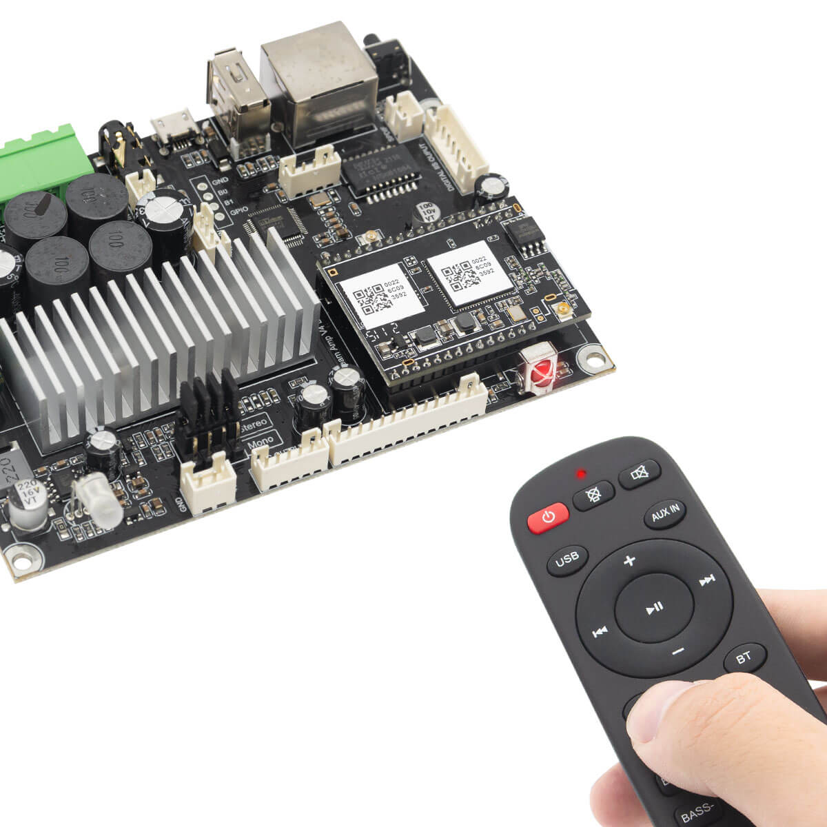

Optional Remote Control
the optional remote control is a useful addition to the Up2stream AMP, providing an easy and convenient way to control your music playback from a distance. Like play/pause, deep bass, adjust volume, and quick switch preset content from a distance.Whether you're listening to music in your living room or in another part of your home, the remote control makes it easy to adjust your settings and enjoy your music to the fullest.

Power Input
12V-24V/DC in
12V-24V 2Pin Connector

*SPDIF In pin connector
Audio output
Analog:
Other I/O Interface
LED pin connector
IR pin connector
Button pin connector
Rotary encoder pin connector
GPIO pin connector
Mono Out pin connector
