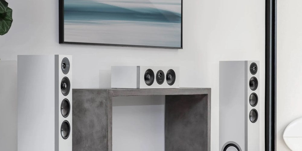

- Positioning:Place the center speaker above or below your TV screen, right there at an ear level when you’re chilling on the couch. This way, you'll get the best sound projection without straining your neck.
- Distance:Keep things symmetrical by placing your center speaker at the same distance from the left and right speakers so everything syncs together nicely.
- Isolation:Don't crowd your center speaker against walls or corners—they're not great for sound. Give it some breathing room to avoid unwanted echoes and vibrations.
