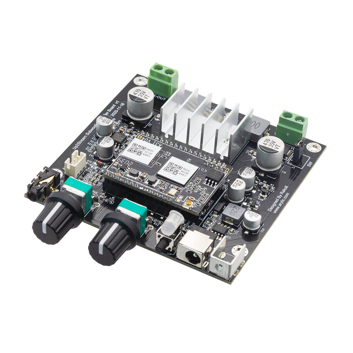

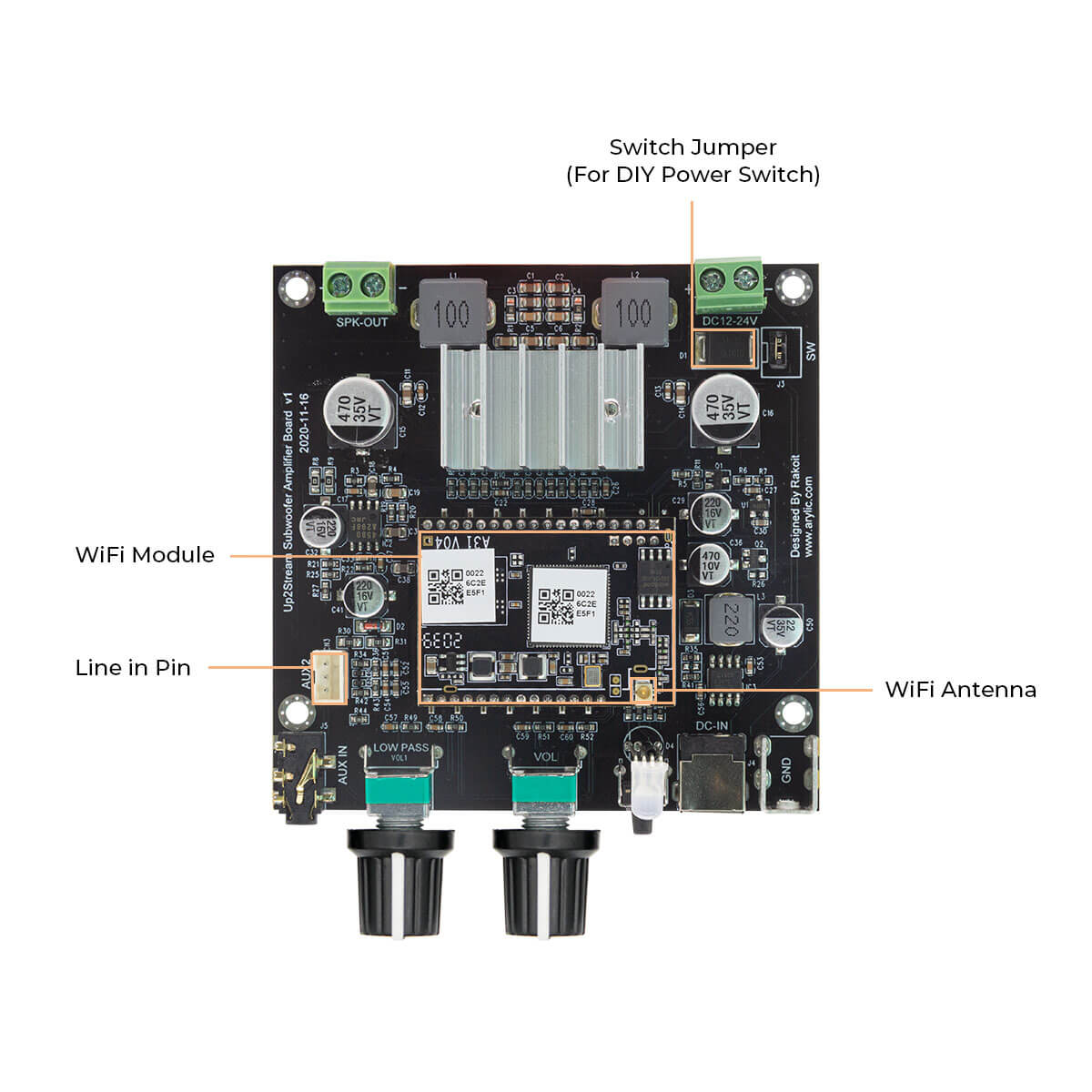

The Up2stream Amp Sub comes with a range of ready-to-use interfaces, including a Aux in audio input, switch jumper, subwoofer output and a plug for power input. Which enables you to create a flexible system according to your specific needs. With these features, you can easily connect your audio devices and enjoy high-quality sound without any complicated setup.

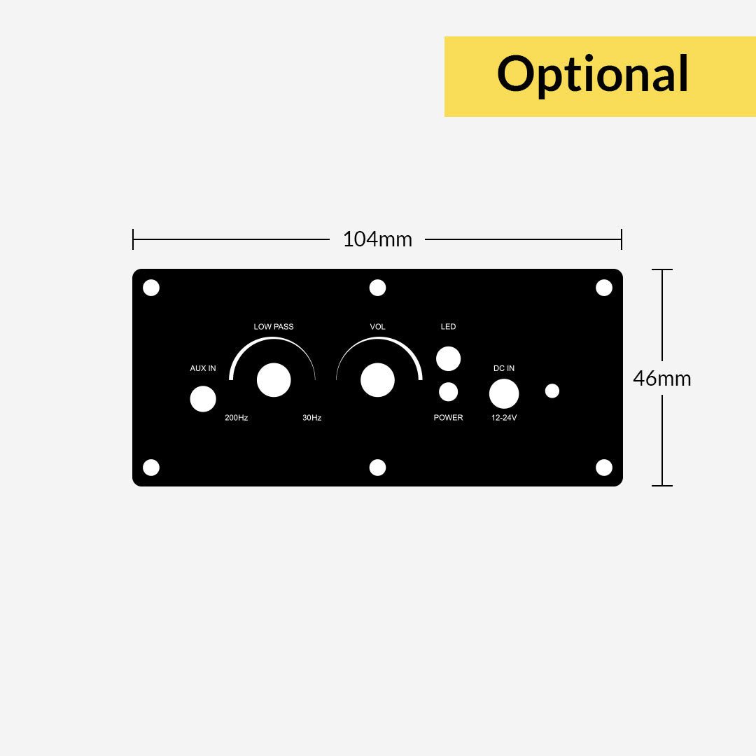

DIY Subwoofer Accessory Kit

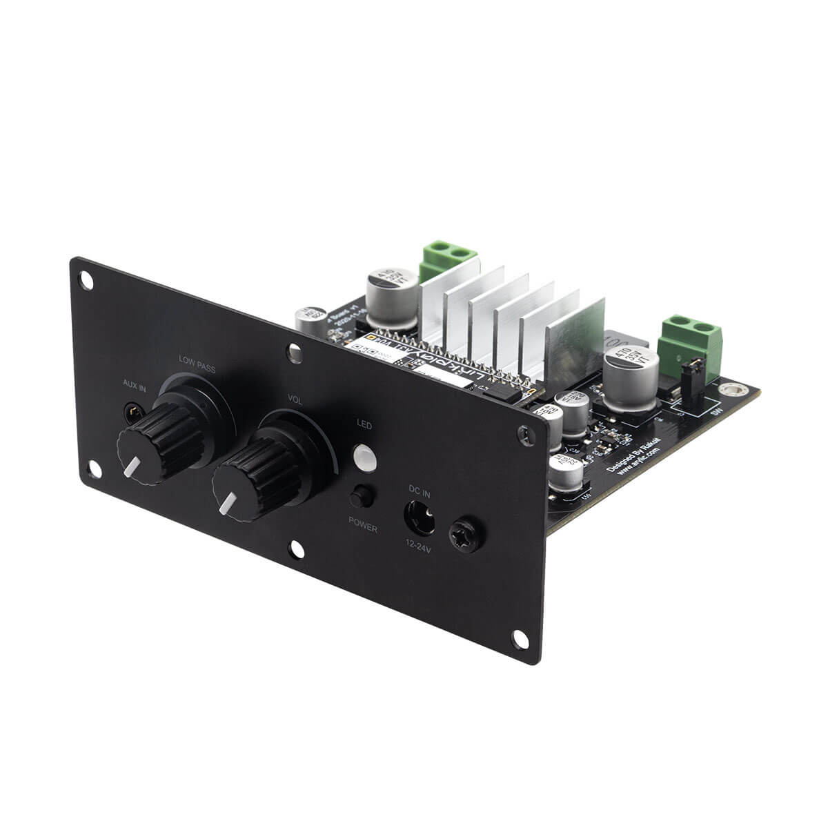

For DIY lovers, we offer a metal front plate and a collection of useful components in our DIY Subwoofer Accessory Kit.This kit will makes it convenient to either integrate an Up2Stream Amp Sub with your current passive subwoofer or build one from scratch. You also can find the other good DIY Bluetooth amp kit in accessories.

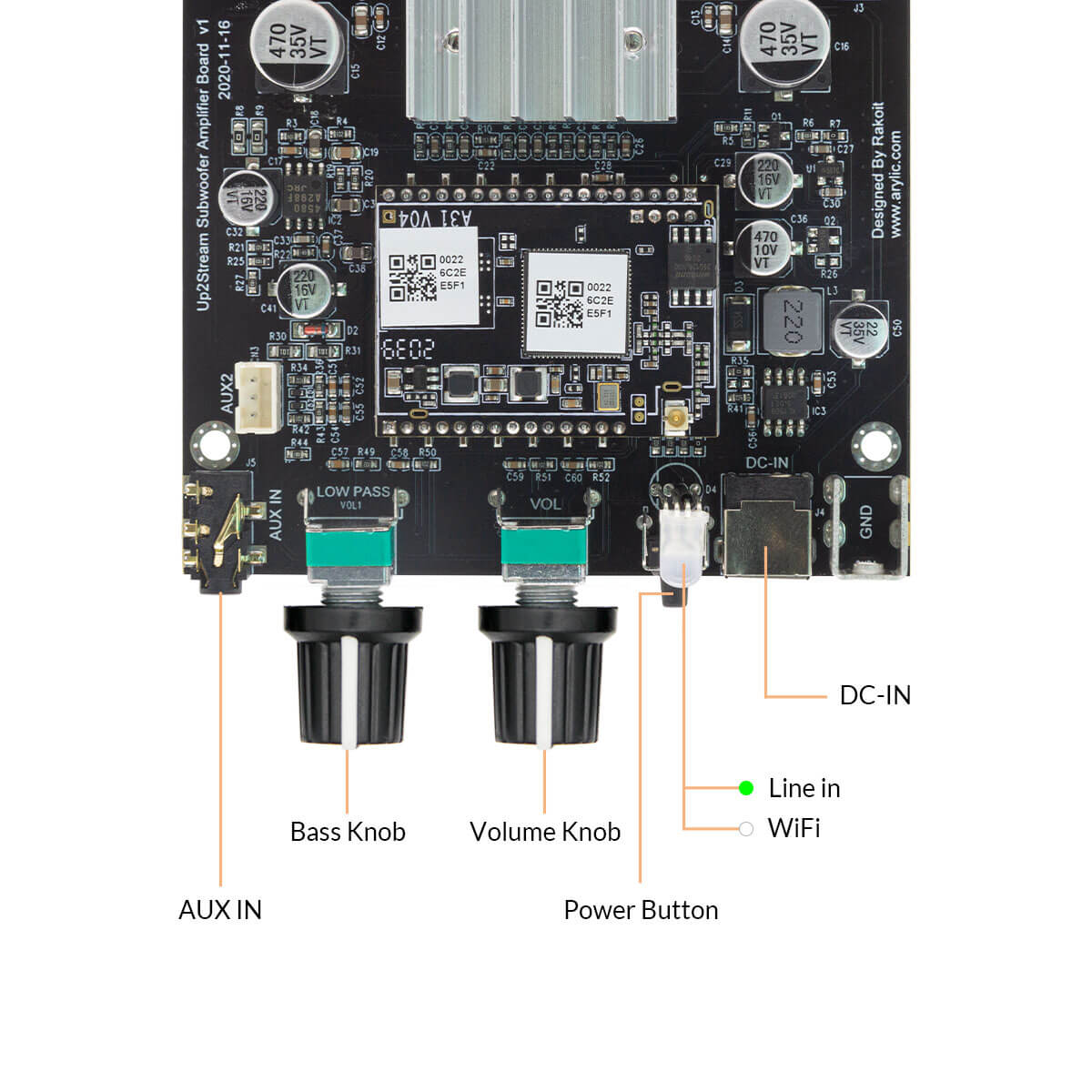

Functional Knob Control
The Up2stream AMP Sub features 2 rotary knobs that enable effortless adjustment of treble, and bass. However, these knobs also facilitate adjustments to the crossover frequency. In addition to controlling sound characteristics, the Up2stream AMP Sub provides versatile functionality for a customized listening experience.

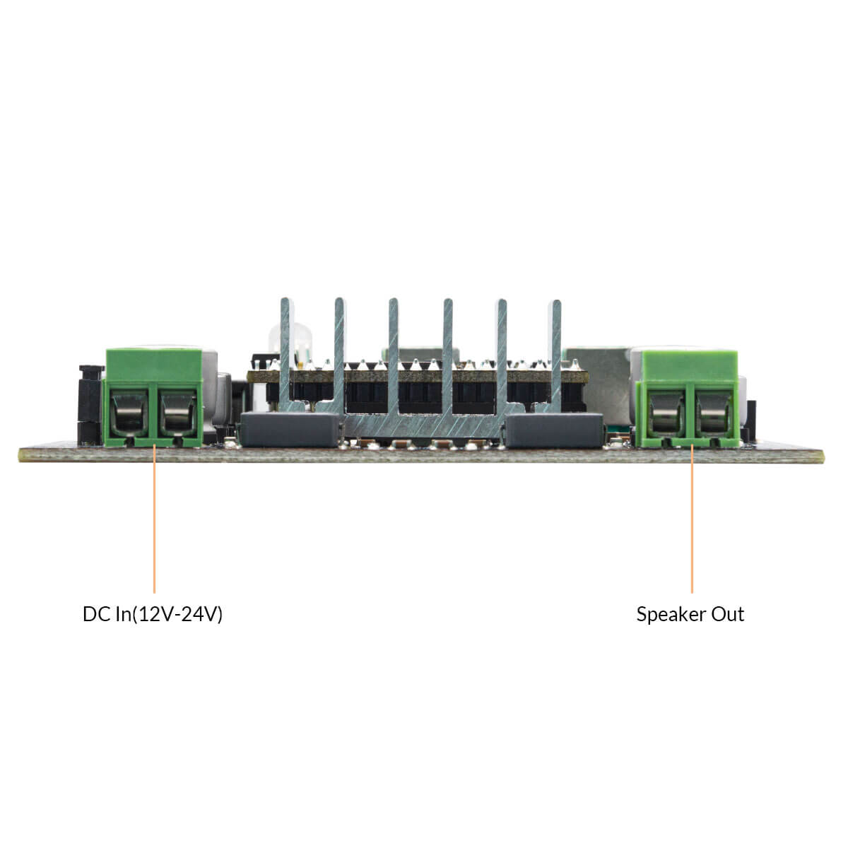

12V-24V/DC in
12V-24V 2 Pin Connector

Power switch jumper

Internal WiFi Antenna

Power Button
Device on:
Long press once: Switch off
Device off:
Short press: Switch on
Bass Knob
Short press once: Reset bass level to 0
Long press 5secs: decrease crossover frequency by 10Hz
(Crossover frequency range from 10-300Hz, default 110hz)
⚪White-WiFi & network mode:
Solid- WiFi is connected
🟢Green-Line in mode
