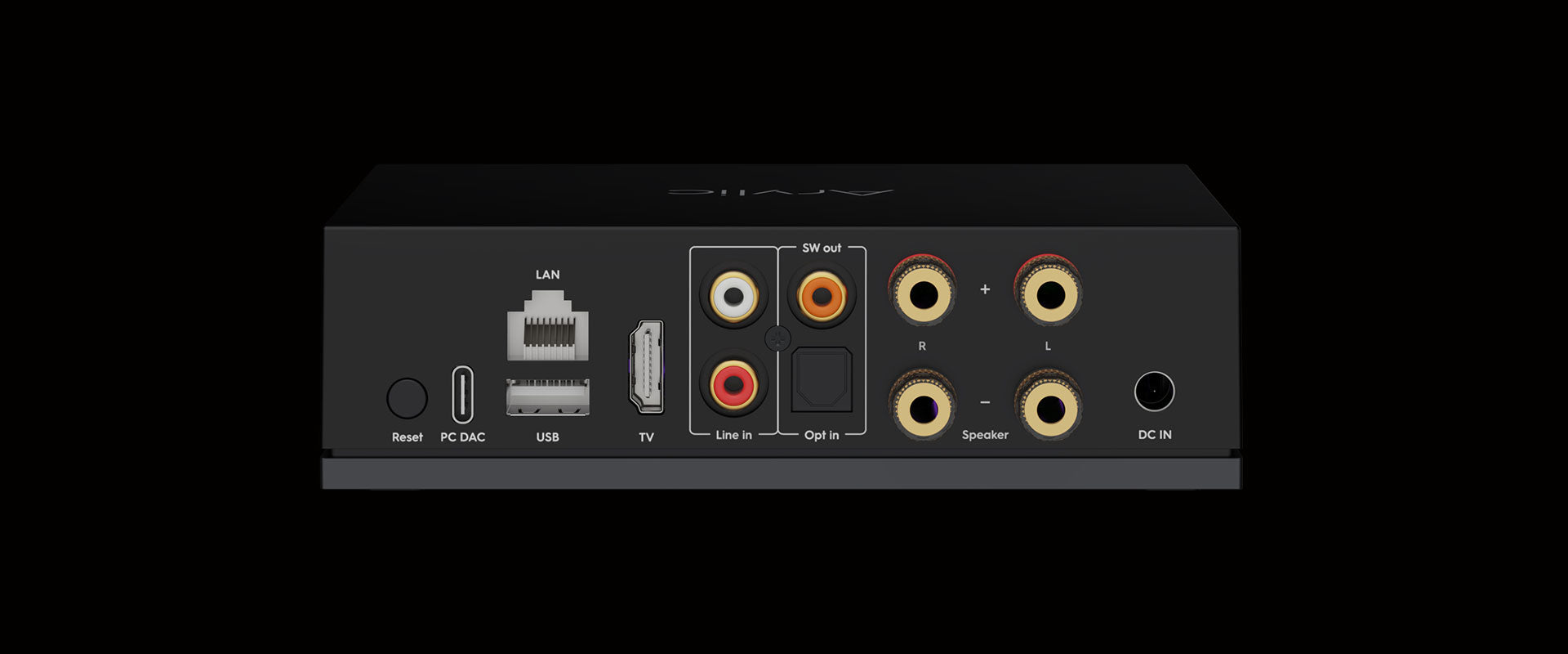

Is the 50W x 2 power output enough? Can it drive my speakers?
The LA50 outputs 50W x 2 at 4Ω and about 30W x 2 at 8Ω, which is enough to drive the vast majority of bookshelf speakers and small-to-medium floor-standing speakers on the market, and speakers with a sensitivity of around 83-85dB are completely fine.
Speakers with nominal impedances of 4Ω and 8Ω can both be connected directly, but it is not recommended to mix speakers of different impedances on the same unit.

Each LA50 is an independent zone (a pair of left and right channel speakers; within the same zone, a second pair of speakers can be connected in parallel to expand coverage, but cannot be controlled independently).
If you want several rooms to play independently, buy multiple units, and then use AirPlay 2 / Google Cast to group them together for synchronized playback or separate them to play individually.

Can the subwoofer crossover frequency be adjusted?
Yes, the Sub Out default crossover frequency is around 250Hz, and specific values and bass effects can be custom-adjusted in the GO CONTROL App's EQ/bass settings, allowing you to fine-tune it to match your room and subwoofer characteristics.
