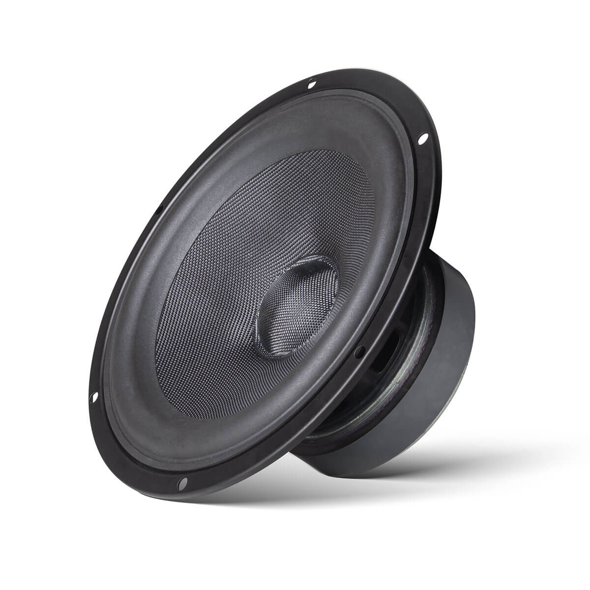

Midbass Speakers with Glass Fiber Cone 4 ohm
Our DIY Audio Products move to Up2Stream.net, Please buy here.
- 50W/60W4ohm powerful midbass speakers for your house party, movie time.
- 39-5KHzdeep bass, natural and rich bass, effortlessly reproducing delicate midrange and bass.
- The S-type paper cone enhances rigidity and minimizes acoustic losses, makes sound waves travel farther.
- Easy to install and full sealing with already mounted EVA.
- New optimized Glass Fiber Cone Design for Low Distortion and High Efficiency.

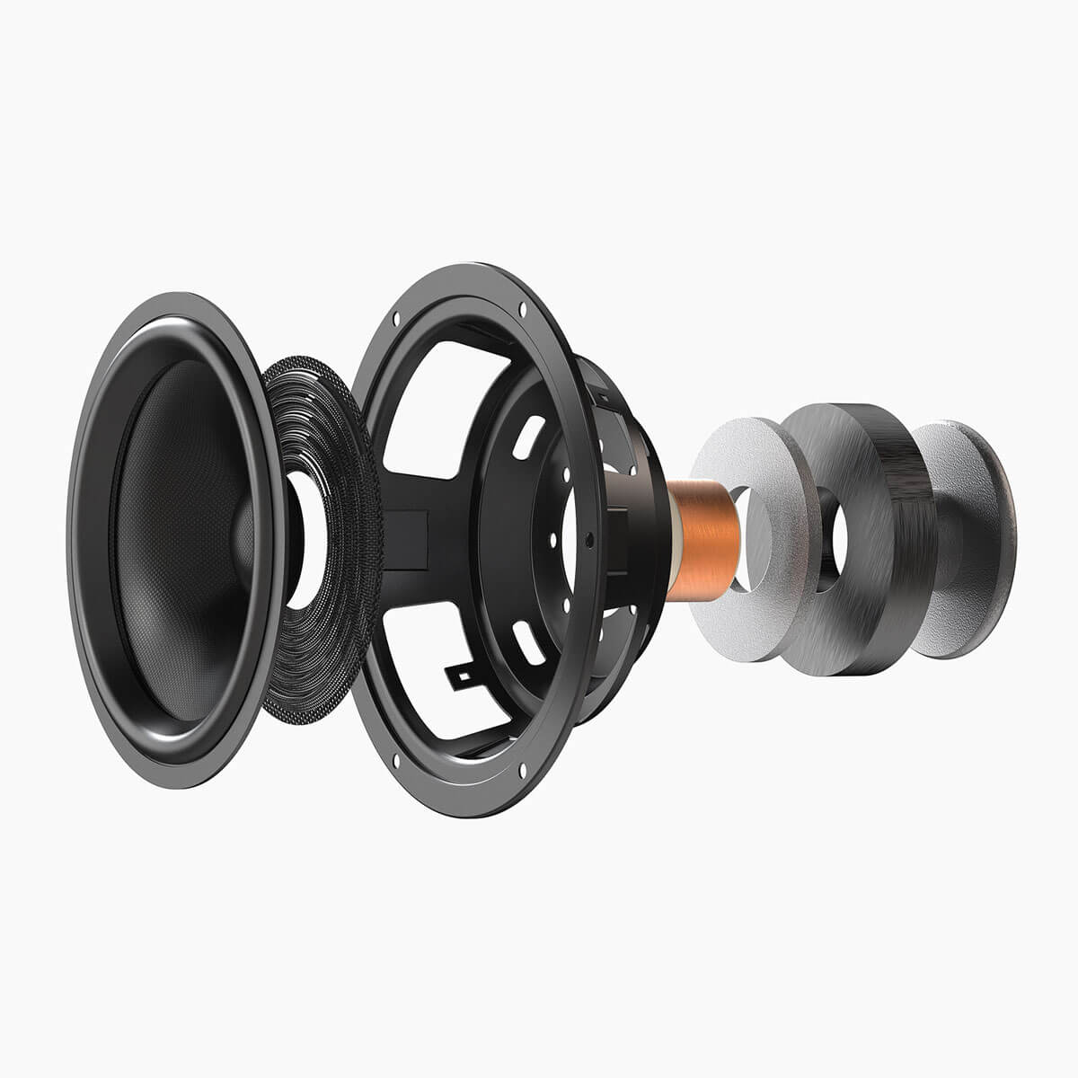

- Our innovative vent design for the mid-bass speakers enhances heat dissipation, improves efficiency, and prolongs the speaker's lifespan.
- Rigid steel chassis with extensive venting for lower air flow speed, reducing audible distortion.
- Vented center pole with dual flares for reduced noise levels at large cone excursions.
- Heavy-duty fiberglass voice coil former to reduce mechanical losses, resulting in better dynamic performance and low-level details.
- Large motor structure for better control and power handling.
- Built-in aluminum field-stabilizing ring for reduced distortion.

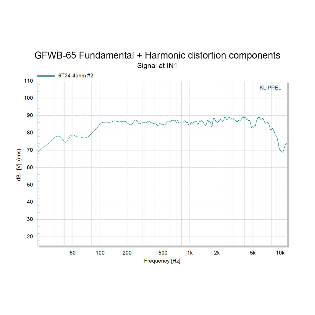

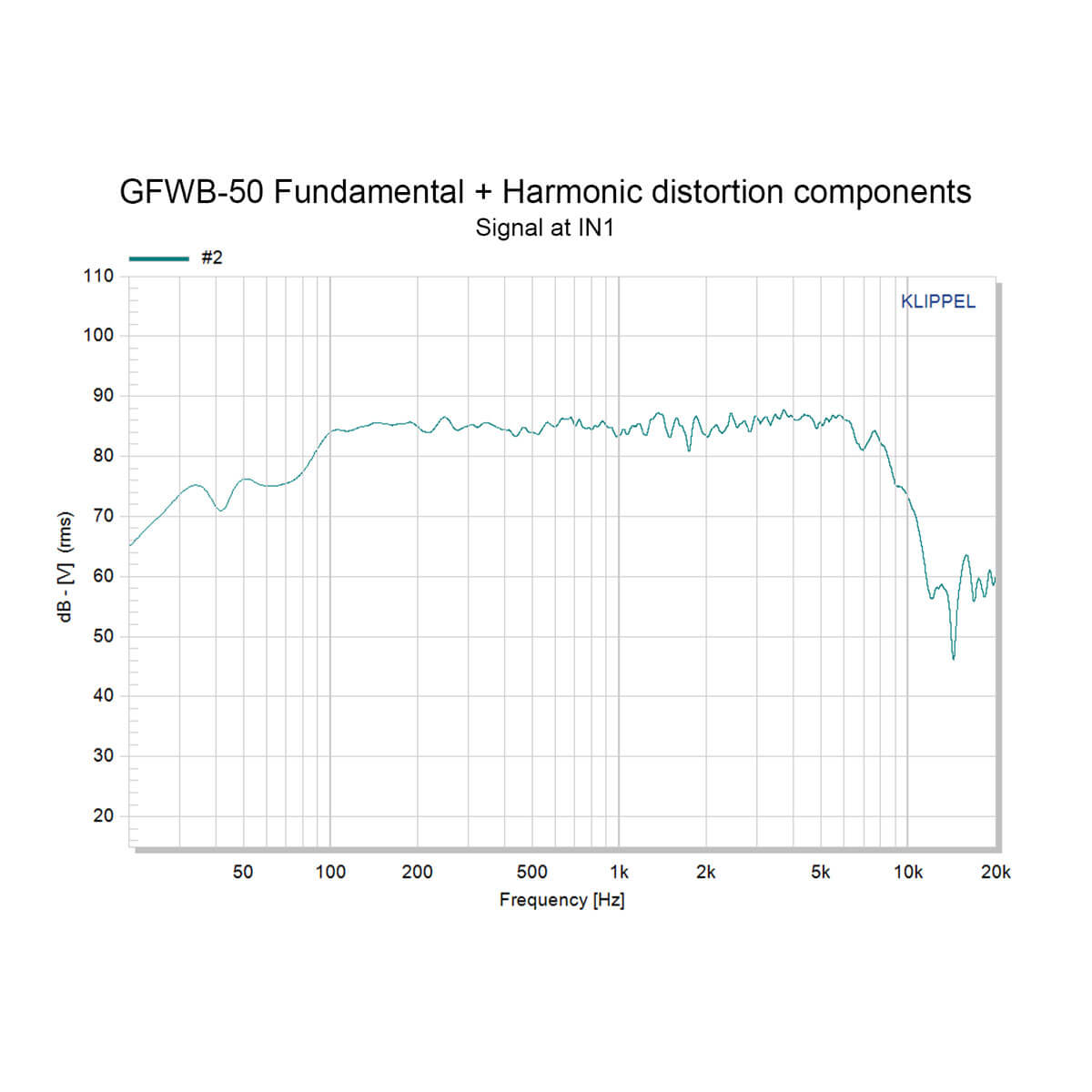

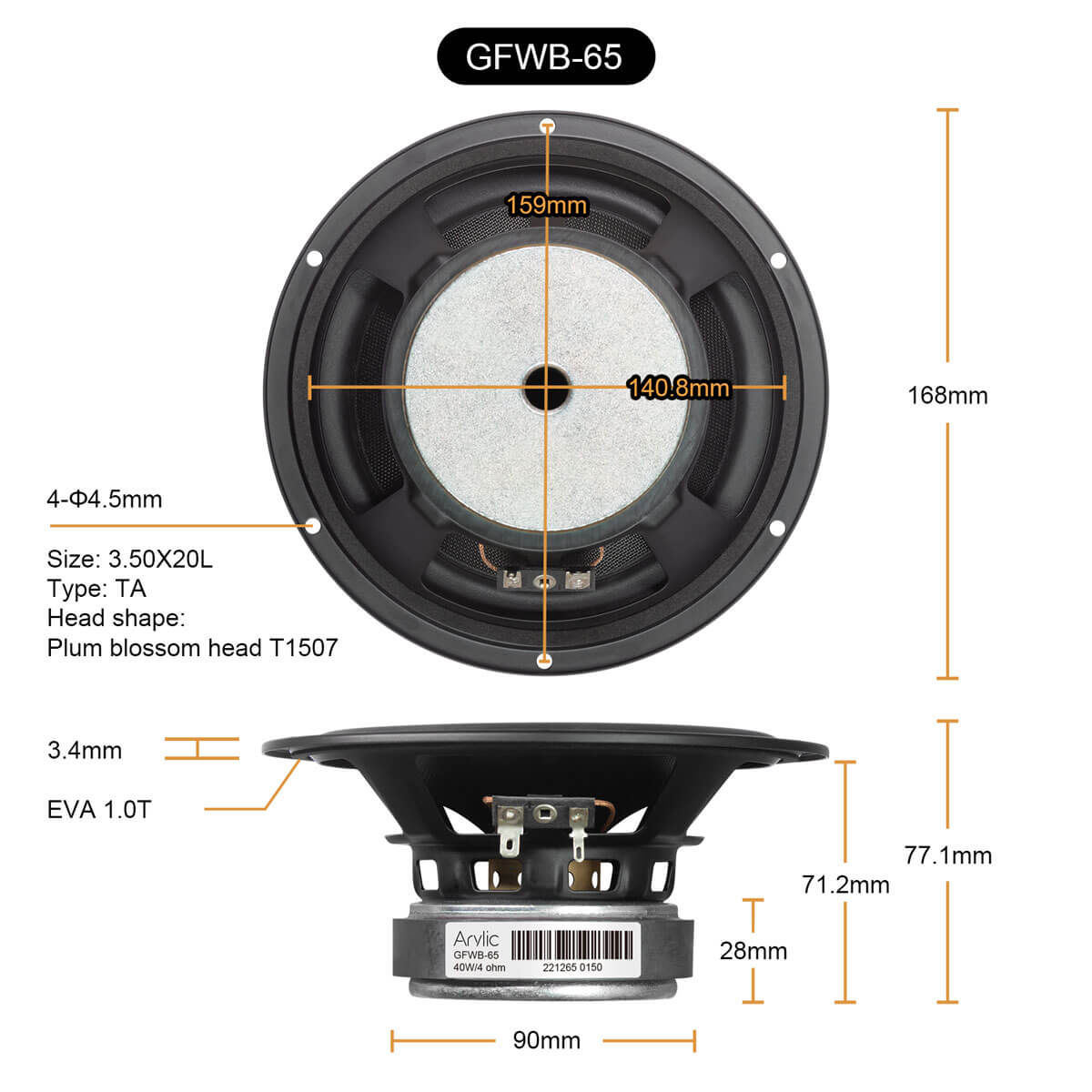

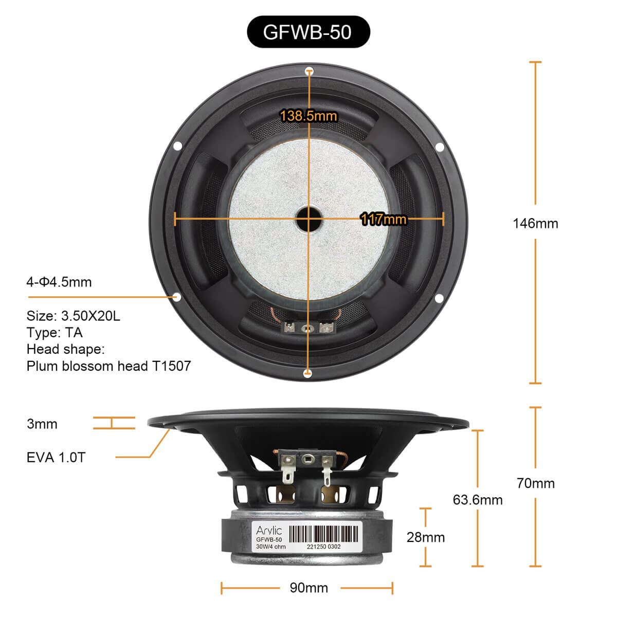

GFWB-50
GFWB-65
Glass fiber+ rubber
Glass fiber+ rubber
4.0±15% Ω
4.0±15% Ω
3.1±10% Ω
3.1±10% Ω
84.5±3 dB
85.0±3 dB
46-6K Hz
39-5K Hz
46±20% Hz
39±20% Hz
32 mm
32 mm
30 W
30 W
50 W
60 W
10.338
10.919
0.4
0.405
0.416
0.421
11.171 L
23.4071 L
66 mm
73 mm
119 mm
143 mm
Ferrite
Ferrite

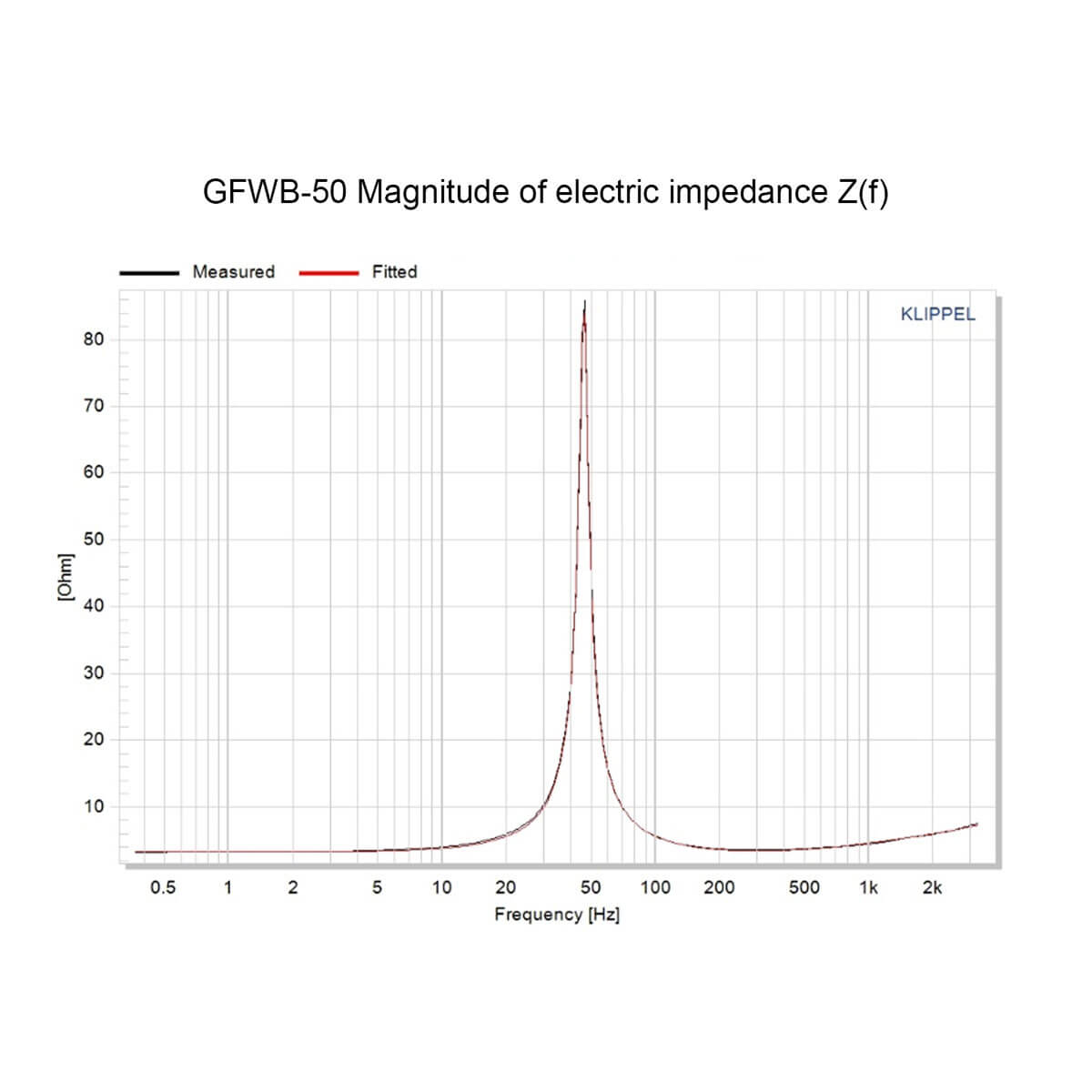

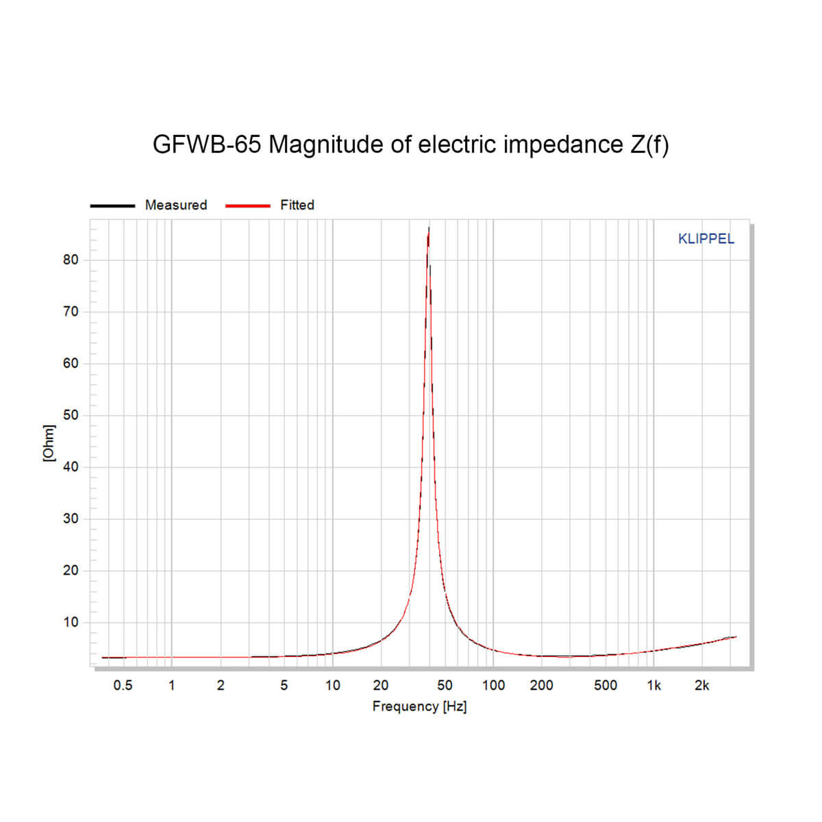

Magnitude of electric impedance Z(f)
Fundamental + Harmonic distortion components
