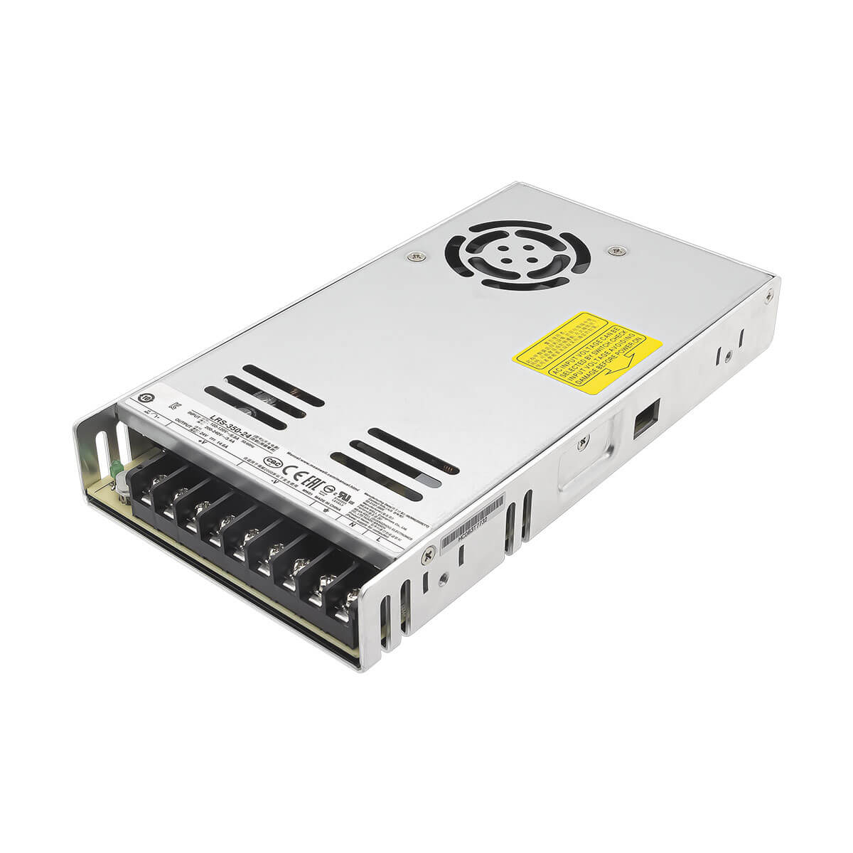

SPS350 350W Switching Power Supply
Power Multiple devices at Once
Unlike normal power supply that can only connect to one device, SPS-350 power supply can provide power to multiple devices at the same time.
High Watt power
SPS-350 have 350W power supply and can provide power up to 4 Up2stream AMP 2.0 devices. You can easily calculate how many devices you can connect by dividing the Watts the connected device required.

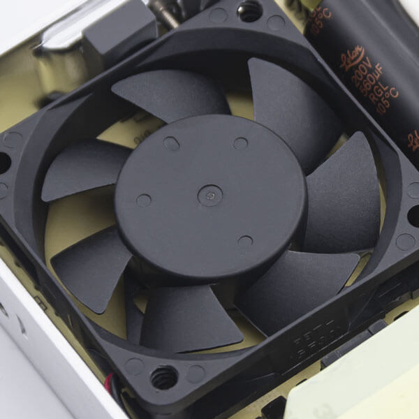

Good Quality Component used
SPS-350 uses Rubycon 105℃ high temperature resistance capacitors, compare to other brand’s 85℃ capacitors, the lifespan is 4 times longer.

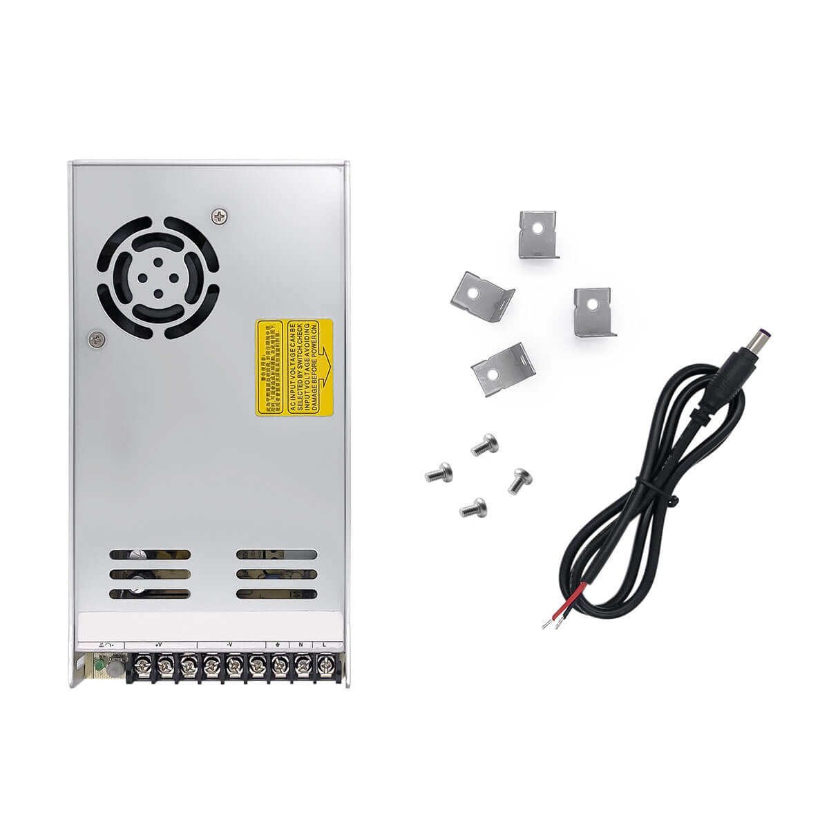

Connect Multiple Power Supply in Parallel
You can connect multiple power supply in parallel for easy installation in the power box and to host more devices at the same time.

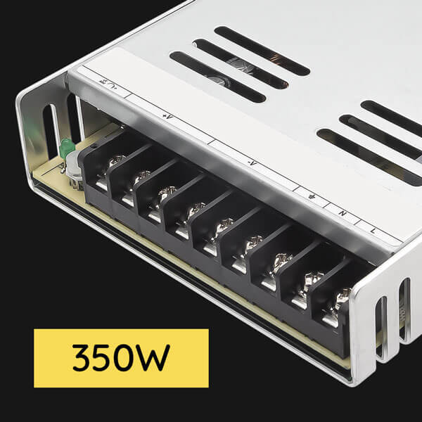

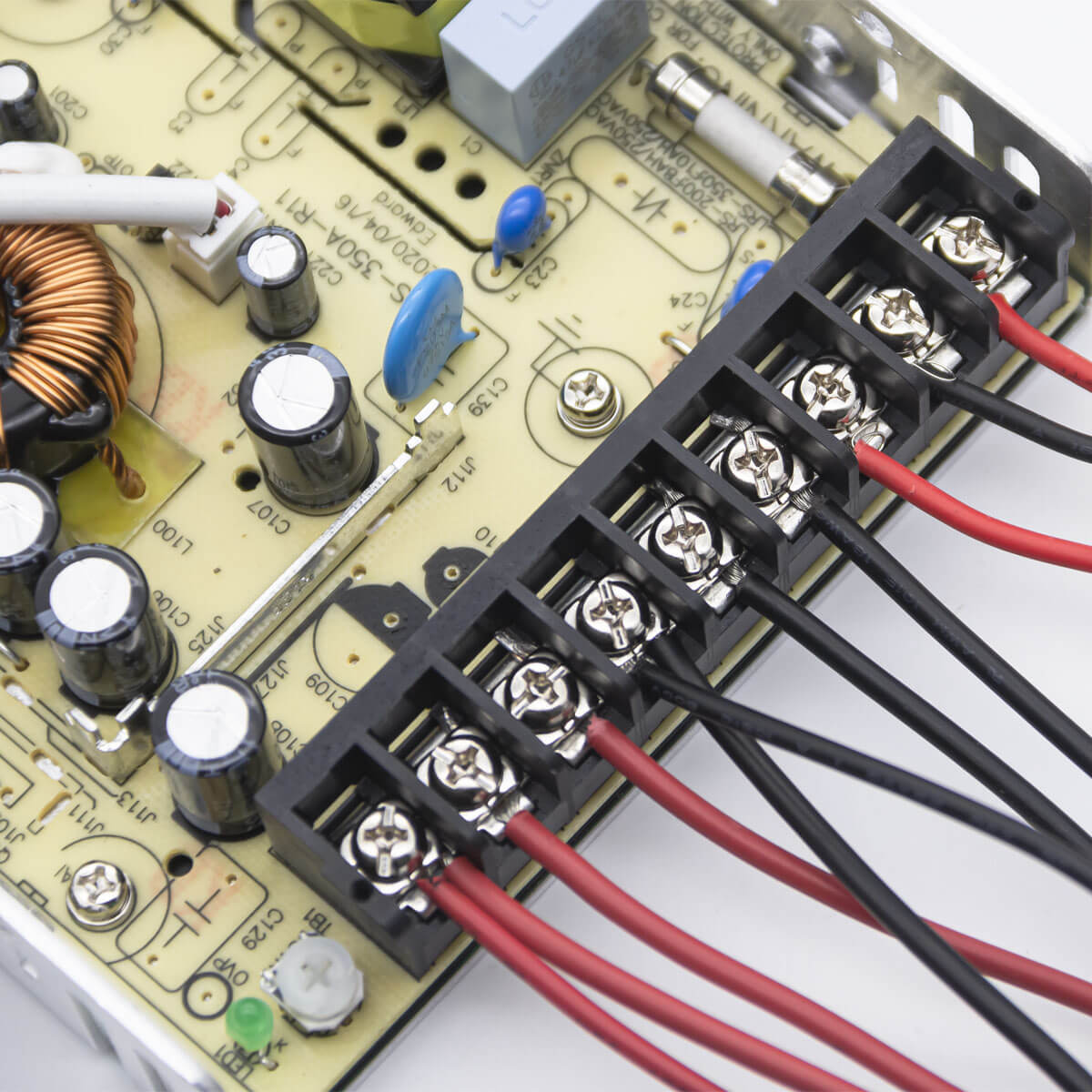

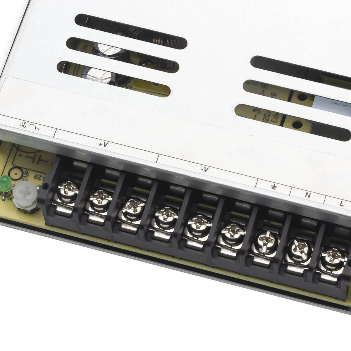

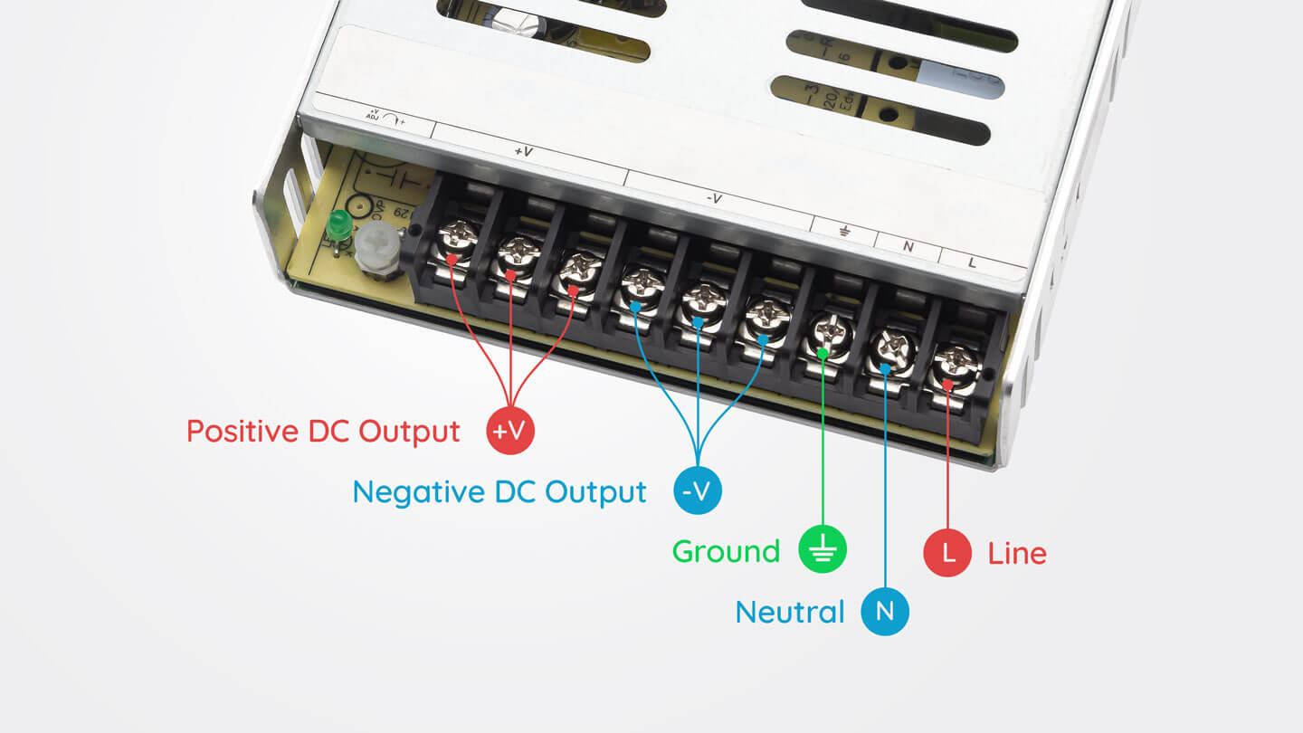

Connection

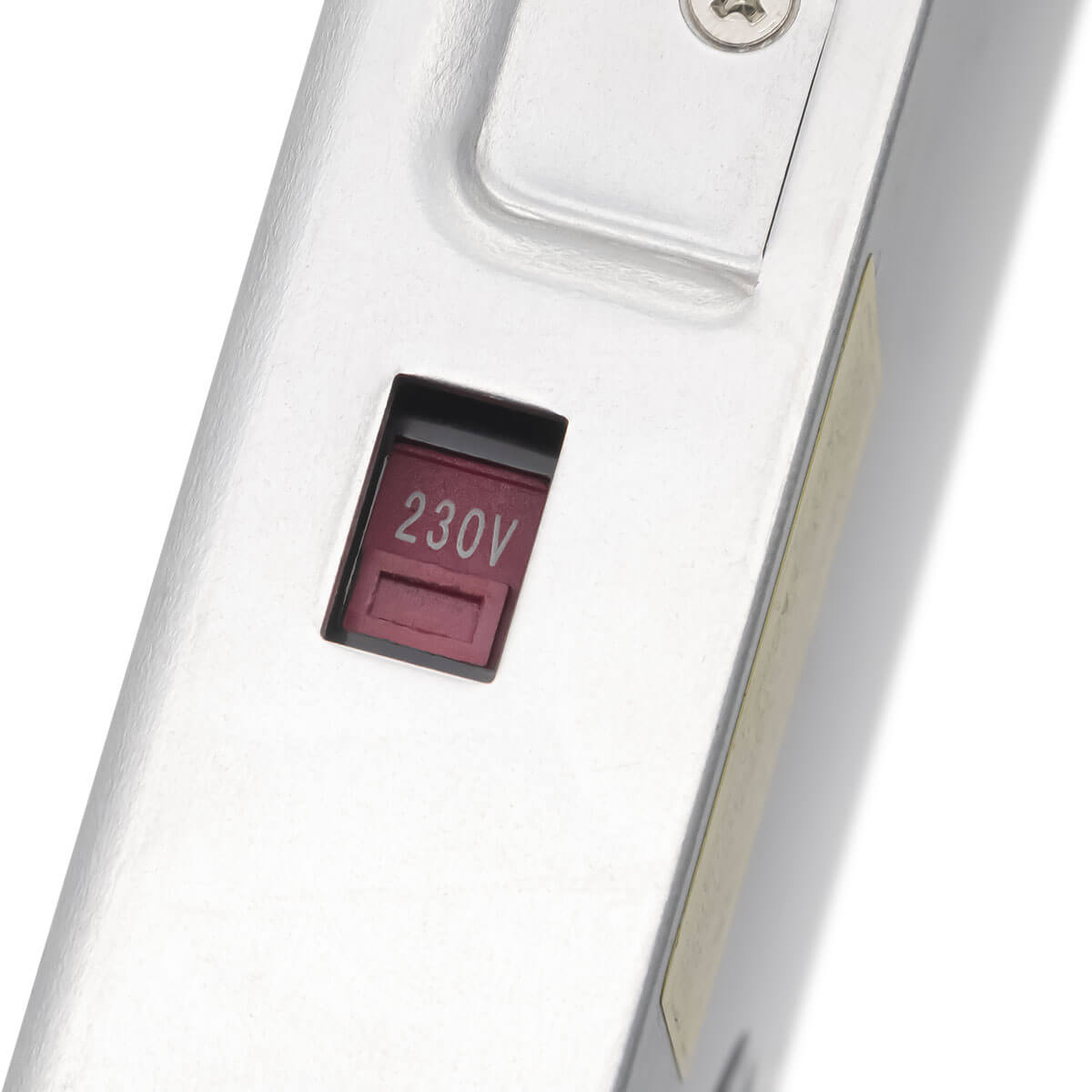

When installing the output power cable, please make sure you connect the cable to correct input/output. Also make sure you check the AC current switch on the side to make sure it is same as your country standard.

DC Voltage 24VRated Current 14.6ARated Power 350.4WRipple & Noise (Max.) 150mVp-pVoltage Tolerance +/- 1.0%
DC Voltage 90~132VAC/180~264VAC by switch
240~370VDC (switch on 230VAC)
Frequency Range: 47~63Hz
88%
6.8A/115VAC
3.4A/230VAC
RTH3>=50 Fan On
RTH3>=50 Fan On
Working Temperature -25°C ~+70°C
Working Humidity 20~90% RH non-condensing
Storage Temperature -40°C ~+85°C
Storage Humidity 10~95% RH
Safety Standards IEC/UL 62368 -1, BSMI CNS14336 -1, EAC TP TC 004, KC K60950-1
EMC Emission Compliance to BSMI CNS13438, EAC TP TC 020, KC KN32, KN35
EMC Immunity Compliance to EAC TP TC 020, KC KN32, KN35
215x115x30mm (LxWxH)
0.76KG
