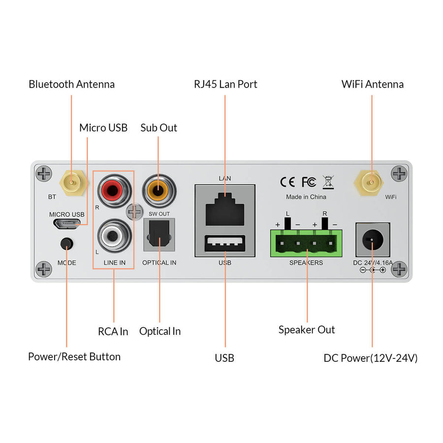

If you see the amp is not working, you should quickly turn it off and remove the speakers from the terminals at the amplifier end.
1. Verify all of the cables
When you turn your amplifier on after installation, a problem with the installation may force it into protect mode. You might want to double-check that it was installed properly if you or anyone else had to disconnect your amp in order to fix any component or for some other reason.
2. Check Amp Temperature
Your amp might have overheated at some point if you've been playing loud music for a while. The amp overheats when music is played at a high volume because more power is being pumped into it. In order to avoid lasting damage, amplifiers enter protect mode when they become too hot.
Lack of enough airflow might also cause your amplifier to overheat, especially if it is installed in a small area. Set up a 12V fan to blow the amp to prevent overheating. If the amplifier functions after cooling down, you might want to move it to a location with good ventilation.
3. Cut the speaker off
Here, we'll attempt to determine whether the issue is with the amplifier itself or the connected speaker. Turn on the amplifier after disconnecting the RCA and speaker connections and reconnecting only the power, ground, and remote leads.
If the amplifier turns on normally, the speaker is the cause of the issue. It has likely already blown.
4. Reset the Amp’s Gain
The Arylic amp's reset button is usually located in the leftmost position behind the amp. Press once to turn off or open the amp, and press for more than 3 seconds can force off and reset the amplifier.
