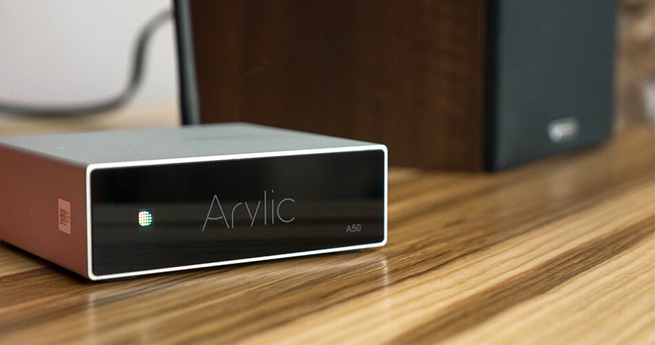

For example, the larger the area to be covered, the higher the volume you need, then you have to pick a more powerful sound digital amplifier to meet your expectations for playback volume. And you must also consider the impedance of the speakers and the power supply, after the combination of each, you can get the power output you want to power your system. Generally speaking, such as some small rooms, perhaps your bedroom, or studio. If you're not listening to the kind of music that needs to be loud like having a party, the output performance of our A30+ audio amplifier will meet your needs. A30+ can power a peak output of 35W*2 at 18 volts, a total of 70W with 4 ohm speakers(35watts left channel, 35watts right channel). And in general zones, such as living rooms, or kitchens are very suitable for A50+ audio amplifier which can power a peak 50W * 2(50watts left channel, 50watts right channel), a total of 100W output at 24V with 4 ohm speakers. And this is the common output specifications for most sound digital amplifiers. If it is an outdoor open space, such as your garden or private backyard, then you need more powerful audio amplifiers, you can choose an audio amplifier product with a total output that can reach 200W. For our product line, you can pick 2 units of Up2stream Amp Mono amplifier board to group them to become a stereo system. This stereo system setup can power 100W for each mono channel, with a total 200W( 100watts left channel, 100watts right channel) at 24V, 4ohm. After the setup, just group the 2 pieces in our 4stream app and sync them as left channel and right channel.

In General, all amplifiers are to be used with passive speakers, so the output wiring is similar. Some amplifiers also allow you to connect active subwoofers, such as our A50+ wireless sound digital amplifier has a bass(sub) output channel to connect to your active subwoofers. That is, you can connect your 2.1 system in series, which you can wirelessly stream your 2.1 system. If you have the need to output to other devices, you can choose this kind of wireless sound digital amplifier product.
