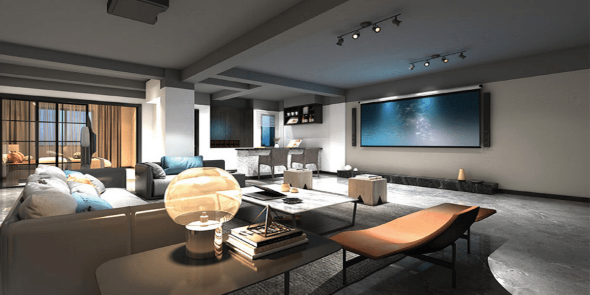

The perfect distance between the front left and right speakers may be 6 to 10 feet, and the seated ear level height is the best position. To avoid boomy bass from boundary effects, place the speakers at least 3 feet away from a corner. The front left and right speakers maybe straddle a flat panel or screen. The center fitting may be just below, it may be sometimes above the position.
For most house home audio setups or home theater systems, we may install surround speakers to the left and right of our major seats. Sometimes, it will be mounted at the rear of our viewing position, or, about 6 feet away from the ground.
However, if you like to listen to a lot of multi-channel music, you would better install them with a higher position that is close to the fronts.
