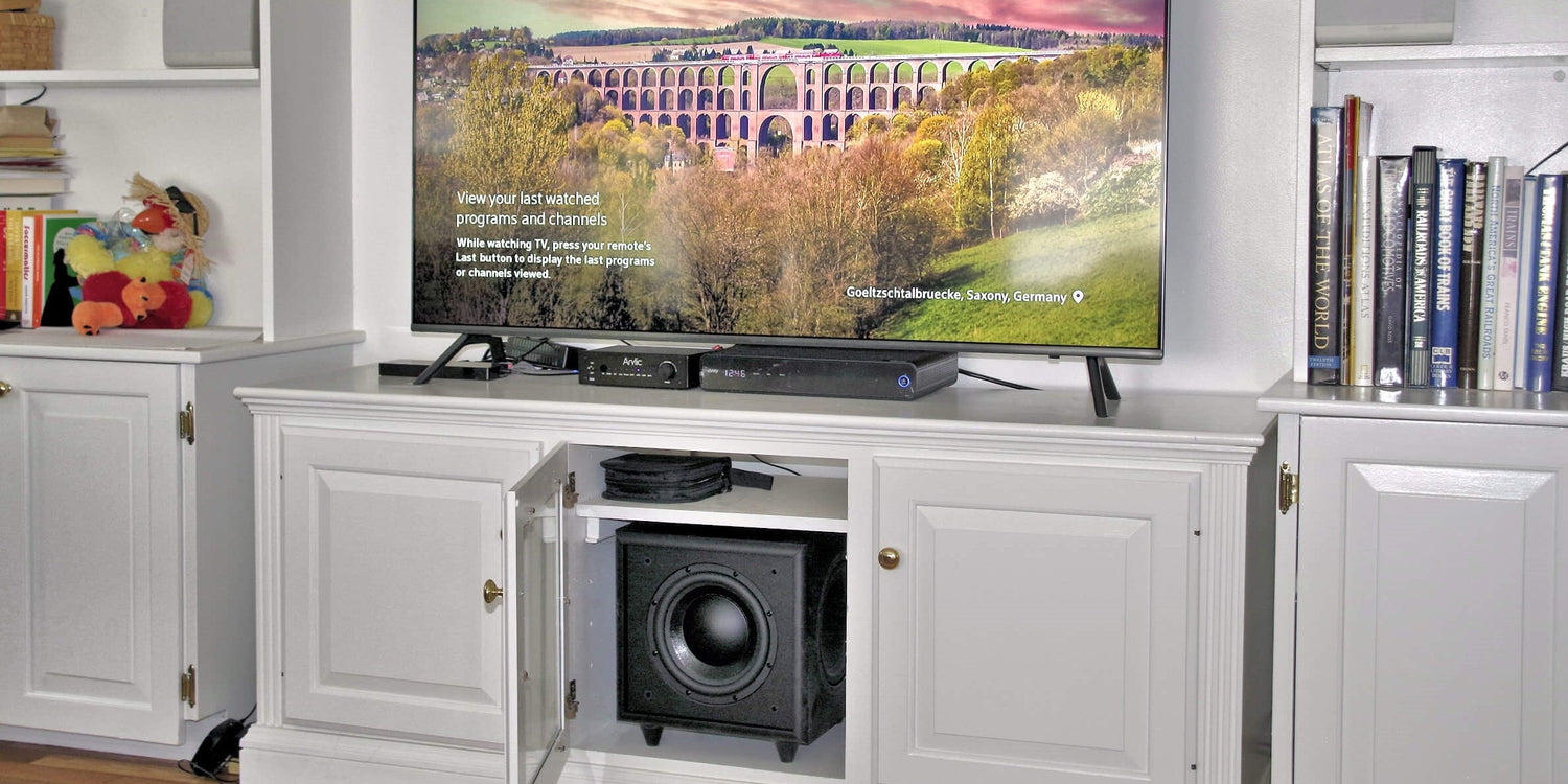

Solution: A mass-market alternative to the SoundBar is provided by a Bluetooth stereo amplifier, such as the Arylic B50, which can also be connected to a TV by HDMI-ARC. The TV does the “heavy lifting” by down-mixing the multi-channel audio into stereo. The Arylic B50 then drives wired stereo speakers and a subwoofer. There are two ways of implementing this:
- Mount a pair of bookshelf speakers, such as the Neumi, Fluance or Elac Debut, beside the TV. Since they are front-ported speakers, they maybe wall-mounted. The Deep Bass (“Digital Subwoofer”) feature in the Arylic B50 boosts their low-frequency output, enhancing the impact of explosions.
- These speakers maynot look attractive on a wall, since they are black and stick out about 9 inches. A more elegant solution might be to use a pair of small, white, on-wall speakers, such as the Polk OWM3 or indoor/outdoor speakers, and add a compact sub-woofer beneath.
These speakers are located far enough apart to give good audio spaciousness and are large enough to give good loudness and bass. They will play 6 – 10 dB below the movie theater reference level, which is still pretty loud. These systems cost between $250 and $500 and can be upgraded to a regular home theater system by adding an A/V receiver and surround speakers.
Connection and control: are implemented using HDMI-ARC (TV is set to PCM output). Control uses the CEC protocol, over the HDMI, so that the TV remote can control the power on/off, muting and volume.
Set-up: may be conducted through a phone app, which allows the amplifier to be tucked away, out of sight, ideal for a tidy system.
Digital Subwoofer: (Deep Bass) This feature of the Arylic B50 simulates a physical subwoofer. It greatly enhances the enjoyment of bookshelf speakers, but needs to be used judiciously.
Surround channels: may be “virtualized” from the front channels by using a DSP algorithm like DTS TruSurround, which is often implemented in a TV.
